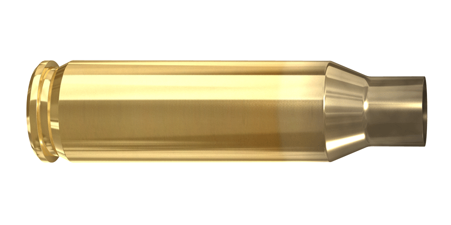

If you don't already have some and plan to use Lapua brass you may want to stock up on some new old stock that's still sitting on the shelves wherever you can find it because I believe Lapua has discontinued making 221FB brass which is the parent case to the 20VT.
Discontinued it??? Whatt???
Per Lapua "This case is no longer in active production."
That's terrible news. Maybe it's just on hold while they produce other things that are in short supply and not being discontinued forever.
