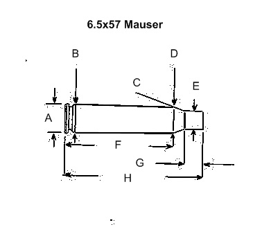

Ok my measurements:
A) .470" (identical to 6.5x57 according to Hornady 9th ed 2012)
B) .468 (identical to 6.5x57)
C) ?
D) .431 (identical to 6.5x57)
E) .300-.295 (each of the 2 rounds measure slightly different)(6.5x57 should be .301)
F) 1.73-1.74 (6.5x57 should be 1.75)
G) 2.91 (identical to 6.5x57)
Length to point G - 1.875-1.890 (6.5x57 should be 1.941)
H) 2.17 (6.5x57 should be 2.222-2.232)
Ok I don't have much experience handloading but I do have a press that I haven't used since I was supervised as a child.
I DO NOT have the dies for this round. I would like to be able to just buy ammo; 6.5x57 as is somewhat inexpensive just with heavier bullets (131 and 139 gr) at slower velocities. But the differences make me think that this is not the correct round.

I used the numbers you gave for base-to-shoulder and base-to-neck, then crunched the numbers for dimension "C" and came up with an included shoulder angle of ~49*. With some Googling, the 6.5x57 Mauser shows to have an included angle of 37.5*. Quite a bit different. With these dimensions, yours looks a little more like the 6.5x55 Swede.
http://www.saami.org/PubResources/CC_Drawings/Rifle/6_5x55%20Swedish.pdf
Given how difficult it can be to get an accurate dimension to the shoulder transition points (radii of the corners) on the brass, the numbers could be off quite a bit. I'd think you'd be better off doing as the others said in getting the chamber cast.

The rifle is chambered in what is known as 6.5 Souper.
Not sure how many of you will be interested in the rest but this is what I've put together:
My grandfather was P.F. Lambert who worked as a supervisor in the Small Arms Research branch of the D.O.D. ~1945 and was in charge of the development of the 7.62x51 NATO. He then recommended to Winchester to standardize both the .308 (identical to the 7.62x51 NATO specs) and the .243 win. P.F. Lambert specially made rifles with his custom stock, an english made action, and Bliss Titus barrel.
Several "souper" rounds were developed by Lambert, which were basically necked down versions of .308 (although all the rounds I have are actually 30-06 or 8mm brass), the 25 Souper being the 25-08 still in use today, the 6.5 souper becomming (as far as I can tell the "original") 6.5-08 (with dies apparently available from Redding?), however, there are several different 6.5-.308 which is what makes it confusing.
