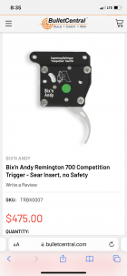

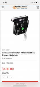

Here's a couiple that might be worth a look:
Briefly’ what’s the difference between the triggers with and without the seat insert ?
The sear insert can be flipped around to change pin fall/cock on close. It’s equivalent to having two different trigger hangers. If you have an action with a trigger hanger you probably don’t need that one. If you want to alter cock on close/pin fall (aka “trigger timing”) you’d change out the hanger. They used to show pictures of it but they’ve changed it and don’t show it anymore at least that I can find.
