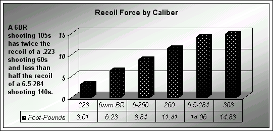

Re inherent accuracy of 6BR vs. .308. They are both very accurate rounds. Our test with Jackie Schmidt's rail gun show the 6BR can hold .2 moa out to 300 yards.
A .308 might do that but you've got tons more recoil. A Palma master might pull it off, but the average shooter will find it easier with the lighter recoiling 6BR.
If the .308 had an accuracy advantage we'd see more people using them in 300m and 600-yard competition. They don't. However you can shoot a .308 in F-TR competition. 6BR would compete in F-Open vs. 6.5-284s and the like.
You really should hook up with some guys and shoot both cartridges. The recoil is much greater with the .308:
