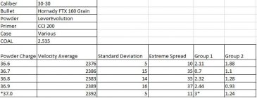

So, really my first time getting a good test done on ammo. Results were mixed. Would like your thoughts. I would just load the one with the best group.
The one with the star beside it I had a flyer. Think it was me.
Sorry, rechecked numbers and was off a little. It is late.
If you're getting those kinds of groups from a 30-30 lever action rifle at 100 yards, I would say you need to go no further. No deer will survive out to 150 yards even with that flyer if you do your part.
I'm running the same powder, bullet, with winchester primer, federal cases at 2.565 in Marlin 30AW. You're in the right area. I load at 37.0 gr snd have shot it up to 80 degrees without any pressure issues. To the point, I never had any solid loads until I got to 36.5 gr, then it starting shooting really good and stayed solid and maintained vertical and spread all the way to 37.5 gr, where I stopped.
I found my flyers were from putting rest forward under forestock wood. Place the rest back near the receiver and shoulder it tight and it does well. Just shot s 5 shot group of 5" at 300 yd on Tuesday, which is it's norm. Temp was 48 degrees. At 100, same day, my group was 1.1". It will hold the same spread at 30 degrees, and at 80 degrees. I would look for the entire range where vertical poi stays consistent and work from there.
FYI's:
1) Hornady says 37.0 is fine and stands by it, though hogdon says 35.5 so use you best judgement.
2) That powder is somewhat temp sensitive, so expect poi to shift.
3) My marlin chamber is generous, and I got 14/1000ths shoulder migration.
EDIT: My velocity at 37.0 gr is 2365 fps.

A couple of my groups were fairly decent. If I can repeat and get 2" consistently at 100 yards, I am good for what I do.
The land I hunt, there is a stand with an 80 yard shooting lane. I took a buck at about 40 yards this year with my 308. Wanted so bad to take the 30-30, but I had not sighted in the LPVO I got for it.
I would add that, in my opinion, the velocity variation should not be a deciding factor in your choice of loads. I'd focus solely on the grouping, and whether that meets your requirements.
Thank you sir. I am headed in that direction. I am a newby and there is a lot of info out there, but that is a simple way to look at it. The one load just blew the others out of the water.

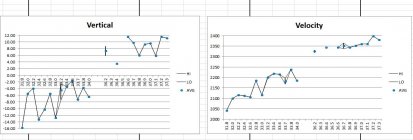

A couple of graphs from my load workup. 34.0-36.0 is not shown because it's just not very stable in that area, at least over temp. I tried really hard, but nothing worked.
FYI's:
I am running probably 20fps above that at 37. Accuracy was the worst at that load.
I may do testing at the lower charges that Hodgdon advertises. I will say, at the 36.5 - 370, the rifle has a thump to it.

Three shots per group.
This was 50 yards, so really the best would have been 2" groups at 100 yards. I ain"t that good, haha.
Marlin 336 with 1-6x32 LPVO.
Additional data on the cases for each group and velocity.

Just looking for the most accurate load, load up 100 or so and move to the next. I am pretty happy with the results overall. And I won't be using this rifle for anything over 100 yards or I would have out a higher power scope on it. So, I will be working out to 100 yards next.
