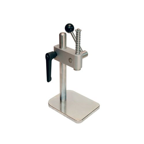

This one works very well on my desk for me:
I like my K&M Arbor Press with Pressure Dial Indicator. I have the Extended Post since I load 375 Cheytac & 33XC on it.I have been using my AMP Press alot too though.I like using L.E. Wilsom Mico Adjust Inline Dies on both best of all. Good Luck in your choice
I have an old Harrels/Sinclair like in the pic above. It is compact, ergonomic and easy to fit in your shooting bag for seating depth tests. I also tried a K&M forcepack but didnt like it: too tall due to the forcepack and honestly, I can feel seating pressure variances better than I could estimate with the gauge. KISS!
21st Century - This is what I have been using for several years and it has worked out really well. It goes to the range with me every time.
One thing I have noticed that appears to be common in a lot of small arbor presses is that when turning the clamping lever/wheel, it does not always hold it in place and it could slightly raise upwards.
I added a shaft collar and this really keeps the adjustable head in place.
I began using a Bald Eagle and it was a little bit less smooth than the K&M I now use. Really, however, both presses gave me very accurate loads with small ES and SD. I have not added the seating pressure system to the K&M, but perhaps will in the future.
