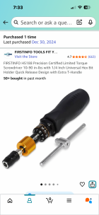

So what's out there currently in the under $100 range for a consistently reliably accurate gunsmith inch-pound torque screw driver.
Really like the fix-it kit with the torque adaptor in it. Keep one in my truck and range bag
Bought a Gear Wrench for $125.00 two years ago. Range is 10-50 Inch Lbs. Bottoms out at 9.9. Calibration is certified and they can recertify if necessary or desired. Great on the loading bench or in the range box. No problems yet. I will PM pics.
