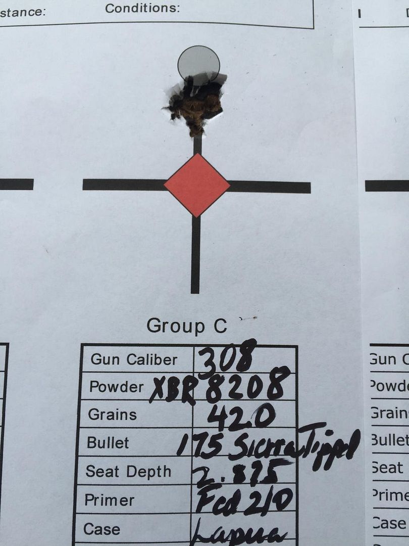

48.3 imr 4064 Thats super hot!
nice group! Mine also groups like that at 100 yards but that doesn't convey to 1,000 yard accuracy since mines falling out of the air around 850 yards.
