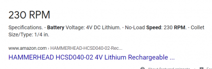

I use this Hammerhead cordless screwdriver. It has plenty of torque and the battery will allow for turning 50 cases or more between charging.
