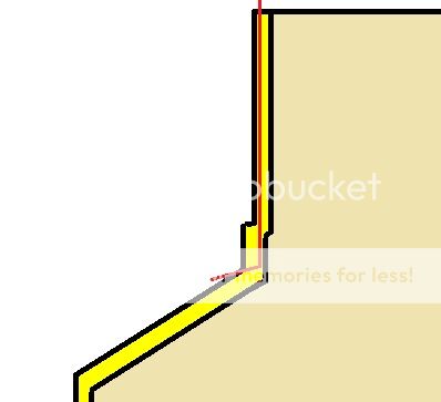

I meant I typically FL size before turning on my other calibers, like 308 or 260. This is my first oddball cartridge where dies are quite a bit more spendy and harder to get. I figured I shouldn't use a bushing die before turning because they don't size the bottom of the neck and it would make an thinner neck at the bottom. I made a pic of what I think neck turning a bushing die sized brass would do because it doesn't size all the way down to the shoulder.

Your assumptions are correct. You need a full length die to correctly neck turn your cases.

I agree. Sorry I should have been more clear or provided a pic.
Found this image on Google and it illustrates what I meant

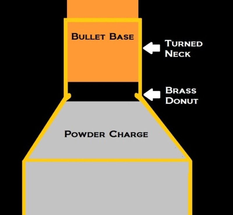

This is a flat base, but a BTHP will typically miss the donut as well. The OP's donut would be on the outside, but the point remains - in theory the donut does not matter if the bullet does not go there. Like I said, I am not sure I buy the theory.

alphapygmy, you're right about the partial neck sizing problem for turning.

In theory, the donut is not contacting the bullet so it does not matter if it is turned (theory, not sure I buy it). Look at how far down the bullet is seated, most BTHP bullets are designed to have the donut fit in the boat tail so that you don't have to neck ream.
I don't think it's theory, but a proven practice. To my knowledge, no one has ever proved the donut to be detrimental to accuracy with bullets typically used in ShortRange BR ( i.e. bullets that are seated well clear of any donut).
There was a theory regarding Turbulence Point, in which case one who subscribes to that theory might argue the donut could upset or restrict the gas flow upon entering the case neck......but prove it on the target results.
