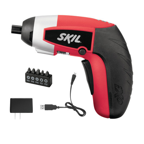

I just started using this one ( $25 )because it can charge anywhere and only weighs a few ounces. I used a friends and was able to screw a 1.5" drywall screw into wood so it has some power and is cheap. I wanted a lightweight driver to drill holes for trail camera mounts and bow hangers in tree stands without carrying a big battery drill. Can also charge it in the car. I did 100 .30 cal necks the other night on one charge and my wrist wasn't sore like it usually is from using the Makita Lithium ion
http://www.ebay.com/itm/Skil-iXO-4V...633649?hash=item4d53d02cb1:g:s8gAAOSwYIxX~Kx7
If you go for the electric screwdriver driver, ( which I use) get the one with a chuck on the end. Some of them the bits can just pull out, which won't be good pulling the case back out of the Turner.
There not a chuck like a drill. But you pull the top back, which locks the bits in.
