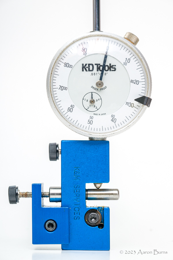

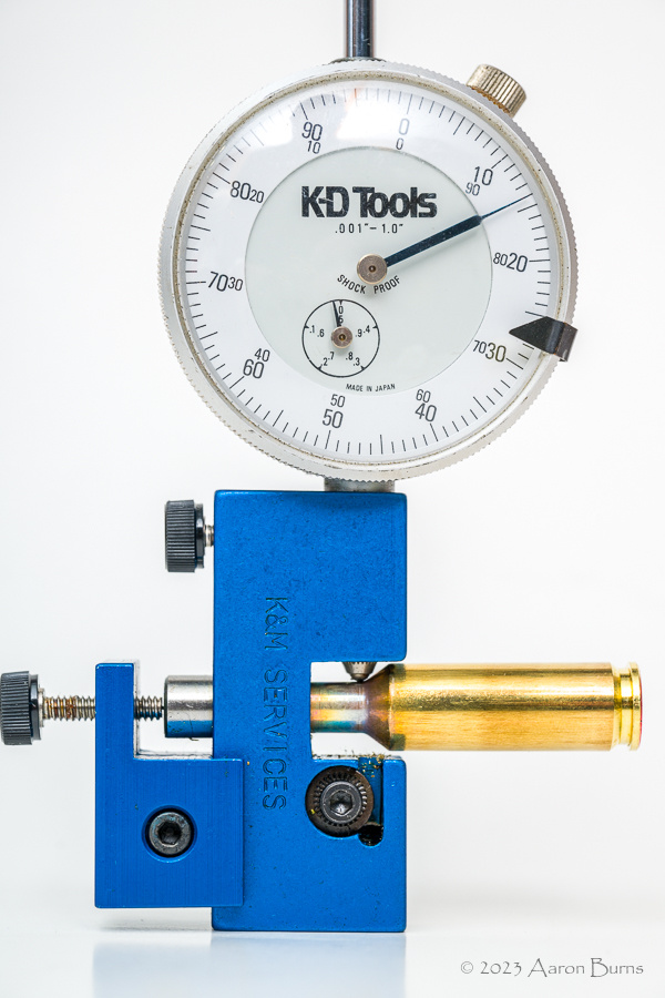

Sequence showing neck thickness - notice it goes from just over .012 to a solid .014:

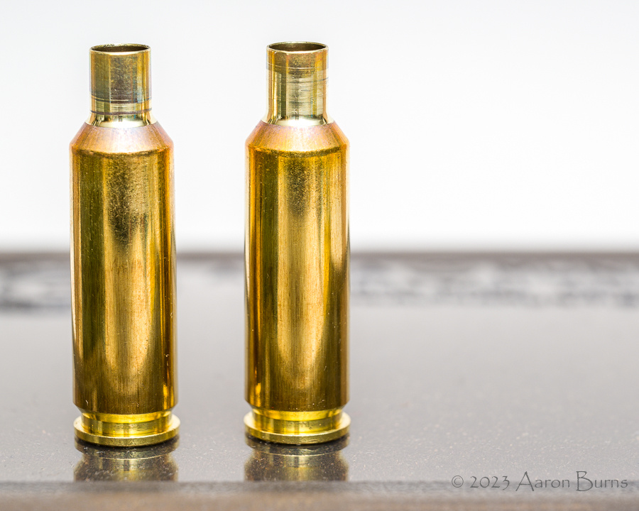

Results of turning to about .0138":

On the first, I used the K&M with a dial gauge, you would use a ball micrometer if you have one.
