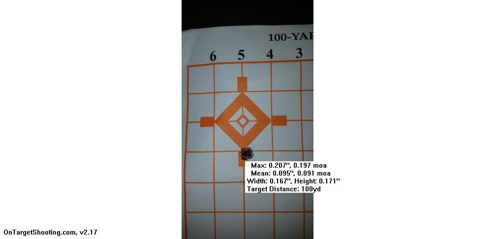

With the hydroseater 8 keep them in the 30's. Over or under sighters.
I don't use my croney except after load development to get average velocity for my kestrel.
D8fference is slight shooting in the 1's and.2's
