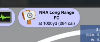

While testing light or less neck tension I had 5 cases that ended up with no tension or grip on the bullets. So light if I turned them upside down the bullet and powder would fall out. I kept those 5 separated for foulers.
When I loaded them in the gun I eyeballed the OAL so it was close to the length of the rest of the box, but they varied widely. I also closed the bolt very slow.
Ive never done a controlled test with zero neck tension, so I was a bit surprised how they grouped, so much so I decided to shoot a few more into the group with the test rounds with 5-10 psi seating pressure. The difference on target velocity and elevation is very significant, way more than I would have ever expected.
The loads are identical other than neck tension and OAL, they were all jumped over .020”, the no tension loads were probably .020” to .050” jump. I’m visualizing the light tension bullets moved to a touch/jam point very rapidly in the firing sequence. Aim point is the same on all shots.
Anyways it produced a very interesting target to ponder.

Did you single load each cartridge into the chamber? The low tension cartridges are going to be highly affected by the speed you operate your bolt closure. When you say you "eyeballed OAL", did you measure cartridge base to bullet tip or cartridge base to ogive, CBTO. I think the modern thinking is more neck tension vs. less or no tension this prevents upset of the bullet in the neck for better concentricity.

I was going to ask the crony question as well Tod. That target velocity is getting to be a whole node slower, so I wonder if the lower node would be worth looking into also. I've never seen tension tests move the speed, or poi very much like this.....BUT I've never tried "0 holds" before lol.

So is that a 1000 yards or six 600
To what degree do discerning shooters trust the velocity readings offered by ShotMarker?
Do the ES/SD numbers tend to be similar? Shotmarker vs. muzzle...
That tends to be a "it depends" answer.
On very windy days, you tend to get more noise in the SM velocity numbers.
On good days, the numbers narrow down and tend to match up well with expectations from ballistics estimates.
So, the general answer is to take them with a grain of salt. They don't cost you anything and I am happy to have them in the data. When they go wonky, usually there is also something wonky with the ammo , but not always.
