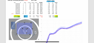

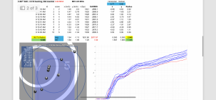

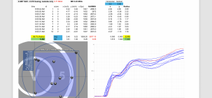

I want to share my neck tension results and get your thoughts on them, especially from @Alex Wheeler and @tom
Maybe even @Tod Hendricks can add his opinion as he did a lot of testing on this topic.
I don’t have a lot of experience with this type of testing, but here’s a quick rundown of how I did it:
Cartridge: 284 Shehane (0.321" neck, no turn chamber)
Brass: Lapua, 0.315" loaded round
Bullet: 184gr Berger Hybrids
I used the same sizing process for all three cases:
Bushing: 0.310"
Case 1: Carbide mandrel 0.284" (used twice)
Case 2: Carbide mandrel 0.282" (used twice)
Case 3: Neolube only
I’ve attached the results and AMP press data in a PDF (3 pages).
I’d appreciate your feedback and suggestions. I plan to repeat the test. What should I change in my test?
Thanks!
@antunRC

Test is done at 985 yards
I would measure what the 282 mandrel created for measurement before and after seating, and include some that are both sides of that amount of "holds" without the mandrel thing or the lube thing. If it was mine anyway, and that's all I had to go on. What kind of "holds" range were these antun?

I'm just preparing to test one more time once I get time to go to the range.
Finished brass prep:
Case 1: Carbide mandrel 0.284" (used twice) - ID check - pin 0.283" minus - pin size 0.2828" (brass ID)
Case 2: Carbide mandrel 0.282" (used twice) - ID check - pin 0.281" plus - pin size 0.2808" (brass ID)
Case 3: only 0.310" bushing, no mandrel, no lube - ID check - pin 0.280" minus - pin size 0.2798" (brass ID)
