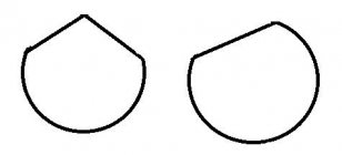

All great advice, I REALLY appreciate the input!!!
How do you all start when your recently fired brass ends up like the picture below??? Either dented on one end or worse....

Why is it getting dinged up? The neck is the most important part of the case. Find a way to stop beating them up. Lay a towel down or something. If this is new brass than just shooting the first time.
Yep, how do you get case necks that look like that...??
I'm imagine stepping on them or they fly 6' in the air and hit a concrete floor.... ???
Not sure how that happens. They don't eject erratically. They come out of the chamber and fall on the bench.
I may need to lighten the ejector spring a little. Sometimes they hit the Sure Feed that I have close to the chamber during a match. It is a Remington Actioned rifle.
Regardless of that issue, what methods do you use to get them right and round?

I ended up cutting 4 coils from the ejector spring and I got nice round necks after the last match.
Also, I bought a new outside neck chamfer tool. I didnt realize you could dull a steel tool on brass. But, i have used the old tool for about 30 years, 10 years in benchrest reloading and it must have dulled... The new one is much better!!!
Everyday is a lesson...
