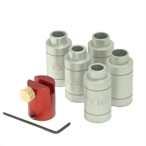

I don’t know if you have a tool to determine how much you are bumping the shoulder back, but, it is kind of a must have. Hornady makes one, as do others. It is important to bump enough, and yet, not too much. Glad you figured out the first issue. Lots to learn and this is a great place to do so.
Hormady also makes a neck only die caliber specific, not cartridge. Sized necks measures same as my redding type s with .288 bushing.
From what I understand, bumping too little = hard to chamber and bumping too much = unnecessary working of brass. I physically checked the chamber fit so that's spot on, and if I'm slightly overworking the brass I don't really care too much. Is there something else I don't know about? Thanks
Its just nice to know exactly where you are at with numbers so that you can keep track and return to them in the future. You may not realize it yet at this point but its important to keep track, its the only way to improve without just stumbling blindly in the dark. I still wonder why I put it off for so long myself.
The hornady tools are extremely useful https://shop.brownells.com/reloadin...MIo_XH-NqC2gIViUNpCh18pwEyEAQYAyABEgJqZfD_BwE
