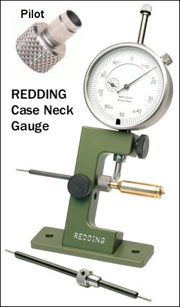

NOTE, if you are measuring case neck runout after sizing with a expander the runout you see can be caused by neck thickness variations. I check my case necks with the Redding neck thickness gauge below and subtract these variations from the total neck runout readings.
