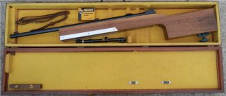

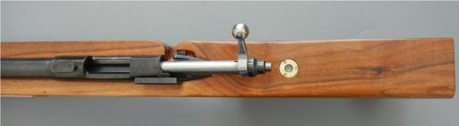

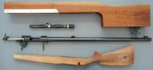

That thing looks like a time capsule.It looks absolutly new.
When I first saw photos of that rifle the single shot picture was not included. The stock looks like the old school benchrest style before the present stock dimension rules were adopted. If it is a 40X it should be marked so but, when Mike Walker was at Remington there is a possibility that an action got out before being rolled marked for model. Homer Culver had one of 3 Husqvarna actions that were specially made in a single shot model.
The mention of Mike Walker was in no way intended to cast aspersions upon Mr. Walker or, his family.
The early 40X used a bolt that had the 722 handle. I would love to take it out and shoot it with a scope mounted on the reciever.
I am guessing it is a 40X then as it has not cutout.
It doesn't look like it has been modified in any way.

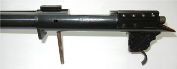

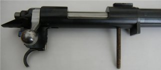

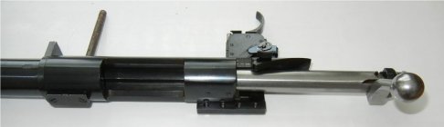

I am just going to put this out there, first off, things don't leave Remington without a Model name, at one time gunsmiths converted repeater actions into single shot, this action does not have the common feed ramp of a Remington 40X, so I think it was converted and in cleaning up the weld work, the Model name was removed with it, it was a 722 at one point.
The X-Man
Look at the last picture posted this is a straight 40x, circa late 50's. No one can weld the floor and remove the model number and finish it like that.

Why is the feed ramp different? I have 7 40X rifles and actions and none look like that.

The big heavy stock is a free rifle 300meter[ blank] with some side metal installed.
It may be a 40x early but it may be a parts put together for the testing tunnel I see some kind of fixture on the bottom of the heavy stock, it looks like some kind of holding device for the type of rest they used in the testing tunnel The extra stock blank is also in the rough.

There is absolutely no indication that anything was welded or filled in, the metal is perfect with uniform color, inside and outside.
The marks on the left side of the action are: 1) the serial number on the action, 2) the chambering (222) on the barrel. There appear to be no date codes on this barrel.

Gerry, the extra rough stock in the 1st set of pics is something I picked up at a gun show a year ago or so with the thought of making it into something I would want to shoot.
Of course, this 26" heavy barrel means I don't want to go haul it out to shoot prairie rats in Wyoming anytime soon, it is bloody heavy.
I am under the impression the heavy stock fixture is for some special benchrest adjustment, but could be something for testing in a tunnel.
Additional marks: the only other marks on the action/barrel are on the exact bottom of the barrel, very lightly struck, matching serial number to that on the action and the bolt.

Looks like a 3/4 inch tube. I see the scope blocks. That rear block on the receiver is for iron sights.
