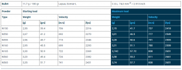

A 284 Shehane is slightly more capacity than the 284 WIN parent, so any 208 WIN data using a 180 can be a good guide for starter loads.
For example these 555 loads using the 284WIN and a Lapua 180 give you a safe start but you can probably skip to the middle of this range for your Shehane because these are conservative.
