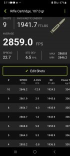

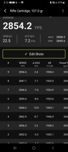

My recent experience with N150 in a straight 6BR shooting 107 Sierras w/450s. Shot on a mini palma target at 100yds using a sling.
