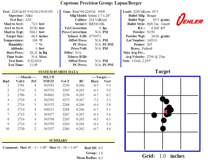

We have 3 - F-TR's in .223. 30" Krieger barrels, 1:6.75 twist. Eliseo, Kelbly and MPA stocks. We let the barrel decide what it likes to shoot. Over time we have found these recipes work for our barrels. Testing with Berger 90gr VLD and Sierra Match Kings 90gr using Varget, RE15 and N140 we observed 2 of 3 favor N140 and 90gr SMK's around at 2,775-2,840 FPS, using 24.3-24.8gr N140 depending on powder lot, bullet and barrel.
Do a ladder test at 500 yards and see, then OCW at 100 yards, then Jump test at 100 yards. Our best jumps can range from .010 to .043.
Berger used N140 and N150 with their 85.5 Bergers....
In House Accuracy Testing
Our initial testing of this bullet in our in house Accuracy Test Center (ATC) showed very promising results as well. Our ATC is a 300 meter test tunnel with environmental controlled conditions and state of the art testing fixtures and equipment. Here, we test our bullets and ammunition to make sure that the performance is where we want it to be. We shot two 5-shot groups back to back and got a 1.00″ group with the first 5 shots and a 1.49″ group with the second 5 shots, which combined into a 1.6″ 10-shot group! The consistently 1/2 MOA group sizing at 300 meters shows just how tight of grouping this bullet can achieve. An image of our in house test results below. We are truly excited about how well these bullets perform!
https://bergerbullets.com/new-berger-22-caliber-85-5-grain-long-range-hybrid-target-bullets/
