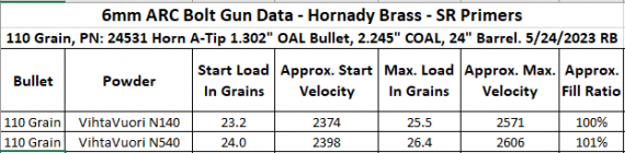

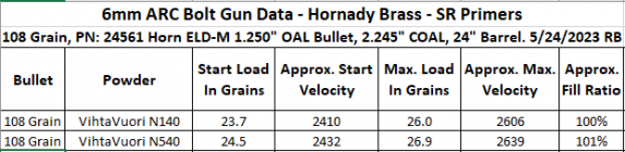

I contacted VV and got some data for my 6MM ARC bolt gun from them. They are 24" barrel and at shorter OAL than I run but a good place to start.

Received email from a Bob Blain from Capstone with a nice explanation that they do not have data for the N135 because it just isn't suitable for the ARC. Not enough case capacity it seems. Though he did provide two nice spreadsheets with data for both the 87gr and 105gr bullets using a wide variety of powders.
Can't say enough about their full and timely response, it is most excellent! Now I have to revise one load and maybe add another!
