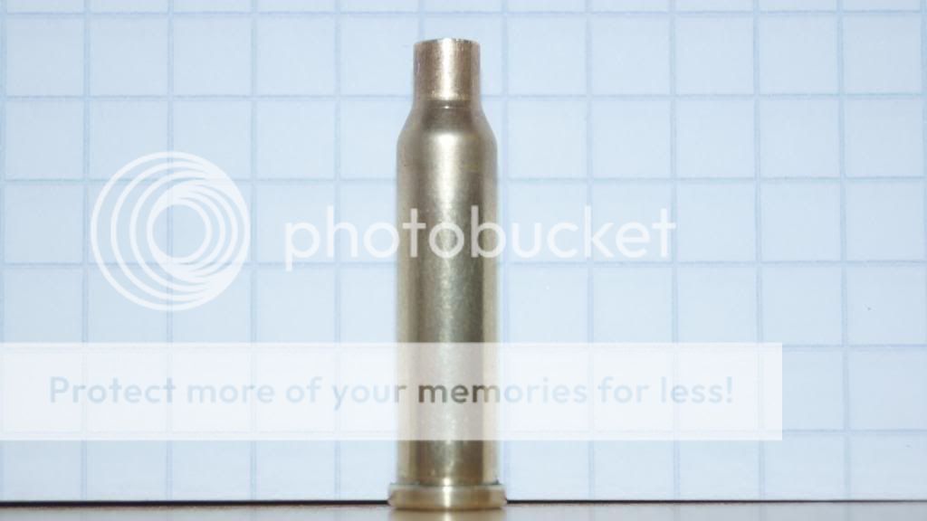

For reloading I am using a shortend 17FB die, lube the case and one pass sets the headspace. The case will grow by .010" so it needs trimmed off again to fit properly. From what I can tell the chamber is very tight and proper length as case .010" over will not chamber. The base is so tight that the case gives resistance with my Winchester cases (a good thing). I am fire forming with 3.6gr of Trailboss or 7gr of Ramshot Enforcer (this is going to be my main powder) with 20gr FMJ Sierra bullets and a Small Mag primer. All in all I am very impressed with the quality of this rifle at this point, once my trimmer gets back I will get some groups shot and report back. Adam

Also the Hornady dies are amazing for 30$ dies. The neck is left with .0025" annular tension, the shoulder is left at .293" (fired case measured .295"). I was very very happy with the results.

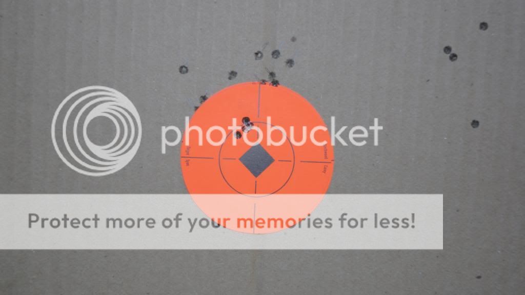

Well Boys here it is, all were fired from 50yds ( to get it sighted in). No cleaning, no shoot one clean one stuff either, all shot from the hood of my truck with the Leupold 1.5-5x20 Vari X-III set on 5.
This is two groups, 25gr of Hornady HP with Trailboss powder

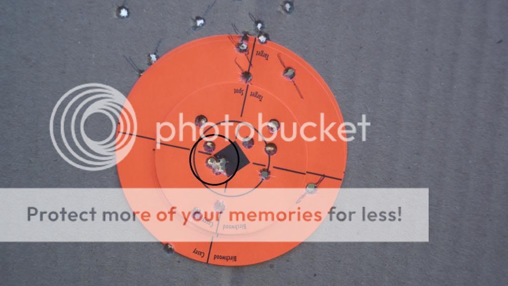

This is also a 25gr bullet with Trailboss
20gr FMJ bullet with TB powder

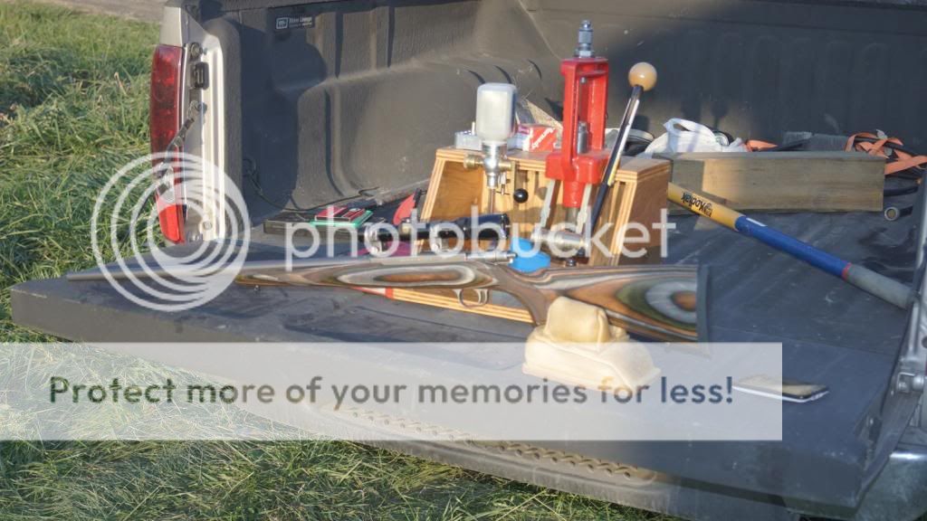

Hero shot of the rifle/ reloading stand.
Even with the barrel bedded out to the forend it shot well, I was impressed. All in all it's a good rifle. No idea on speed, probably somewhere inthe neighborhood of 2200fps. I'll break the chrony out soon and put some fast powder is the cases. Adam
