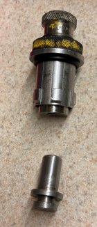

I think I know the cause of the problem! The base needs to be sized more than a conventional die can do. You must make a push-through die and size the base about .002". I had the same problem with my 6.5/284, and this fixed it! I used a .284 die and whacked it off until I got the correct diameter. You must lube the crap out of it and go fast, or it will stick!
