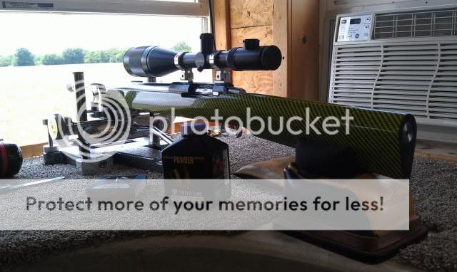

Ok its been a long wait but it is finally home. My newest 6ppc Heavy varmint rifle. Here is the run down!
- Bat Machine MB dual port
- Bob Scarbrough Heavy varmint carbon fiber stock.
- Heavy varmint Krieger 13 twist barrel chambered by me in 6ppc. 263NK .060 FB
- Jewell trigger
- NF scope. Number 3 reticle small dot. I love this scope!!
- Buckys barrel tuner installed by me
I chambered the Krieger barrel up last night but didn't have any day light left to shoot. I woke up this morning at 5AM and headed for the shop. had to turn some brass first thing, then I got started on break in. The n133 with the fowler bullet, has been a long proven match for me. Looks like this barrel is going to shoot the fowler somewhere around .020 off full jam. That's about normal. 29.8 grains of 133 looked the best, but to early to say for sure.
Temp today was around 85 degrees with a west wind around 12MPH. Lots of mirage to deal with to. Not ideal conditions!
The rifle tracks extremely well in the NEO rest. The barrel showed no copper fowling, so I shot a few 4 shot groups, just to get a feel for the seating depth.
N133 and old fowler bullets got the call. The groups thus far look promising. I was blowing out brass as I went, so I didn't expect to much.
The Krieger barrel cut real nice in the lathe, and while slugging before I chambered, the bore felt nice and consistent.
The stock is a thing of beauty. I waited a long 10 month for this stock, and let me tell you it was well worth the wait. I love the color, and more importantly I love the feel. Bob Scarbrough builds one heck of a nice stock.
Let me know what you think. Enjoy the pics. Lee

after I took all these pics and right before dark I went back out to the range. At 29.8 grains 133 and .025 off the jam this barrel stuck back to back to back 5 shot zeros. phone was dead so no pics. I think it will be a real solid barrel/rifle.

I put the tunner on just for the pic. I'll finish tuning the rifle and then add the tuner. I really havent even started load work. I do however have a good idea where to start now.
