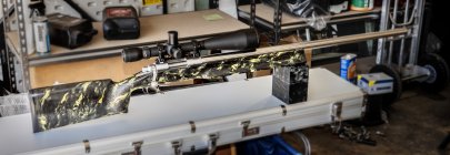

After exhausting what little patience I have on various versions of my Savage 12BR rifle, a few months ago I bought a used BR rifle with a Rem. 700 short action, Jewel trigger, and a 30" heavy barrel in 6.5-284.
