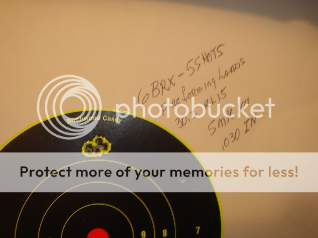

My BRX is one of my favorite rifles, and is very accurate. The barrel sit's on a Savage Action and F-Class Savage Stock. I just built a dasher and I am curious how it's going to compare to my BRX. I will post pictures after dialing it in.
Below is a picture of a 5 shot group. 3 are pretty tight. I have shot <.200 5 shot groups, but don't have a picture of the target.
