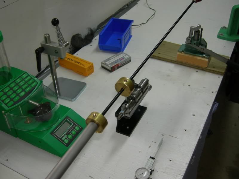

Here's how i measure my OAL, It works well.
