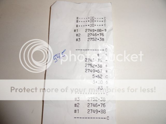

Below is a pictures of my new 284. I am still developing a load for it. I only shot these rounds @ 100yds to get the chrono results.

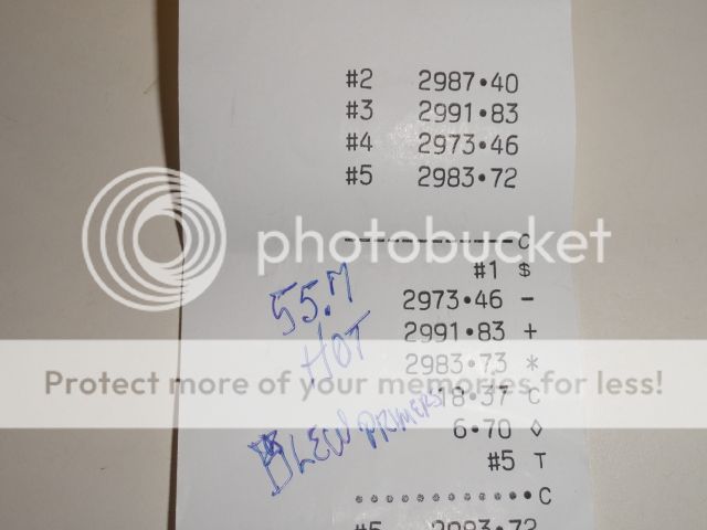

Below are pictures of the Chrono printouts. I don't know if my Chrono is broke, but the results change with every load.
Has anyone experienced the same results that my 55.5 load is showing? Going from 54.5 to 55.5 grns pushed the bullet over 200fps faster, 4831SC. ? ? ? Hard to believe .2 grains makes this much difference on the SD & ES.

54.5 load, 3 rounds, brass and primers looked good
55.5 load, only 4 rounds, brass and primers looked good, no pressure signs
55.7 load, 5 rounds, blew one primer, others showed slight pressure signs, to hot

My input is you likely have a chrono problem. The first set of data looks normal for a .284, while the next two are WAY above what folks get with a .284 and a similar charge, not to mention 1g of powder will not give 250 FPS more, its more like 50-75 feet more...

It looks like you need to take a look at the chrono. You gained 200 fps with one grain of powder. That is a bit much. Do you know anyone else that has a chrono you can verify with.

54.5 produces 2,750 fps, ES of 5.62 and a SD of 3.00. Very accurate at 100 yards

I know it's only 4 shots, but an SD of 0.00, well I have never seen this. And yes, I do have friends that have chrono's, so I will verify the speeds with their's.
