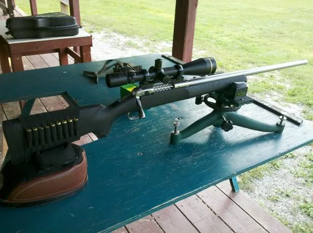

My Hot Rod 20BR....
DogBuster
Built this one in March 2012....keep saying...'the last one'...
Specs are...
Savage Target action w/14 oz trigger pull
Pac Nor 28" x no taper large shank prefit Savage tube
9 twist 3 groove
Vortex 6-24x50 SFP PST mounted in Burris x/high 30mm rings
PTG spiral fluted bolt (needed some bling)
'Boots' Tactical oversize bolt handle
Choate Ultimate Varminter stock
Tips the scales a tad over 18#
Longest p/dog confirmed kill @ 775 yds with 40 V max
Just started working with the 55 gr Bergers...the 40 V's are soo awesome in the p/dog fields...recoil is non existant off the table..
The Berger 55s work well with IMR4007ssc..VV N140 & RE17
Brass used is reformed 6BR Norma taken down to 20 cal with Redding 22BR FL sizer...Redding 20BR bushing neck die...seater is std Forster BR..have yet to clock either bullet..Chrony is on the blink.........stay tuned...Be interested to know actual velocity other 20 BR shooters are getting...3650 w/55s ? 4100 w/40s (moly)...shot this target today @ 100 yds...

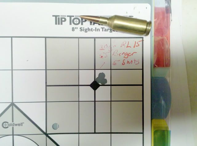

Very nice, you will like the 55 Berger's maybe not better than the 40 Vmax on Pdogs but they work great on groundhogs and coyotes I'm getting 3650 with RL15 although I have backed it down to 3550 also tried some Varget but the RL15 shoots a little better,

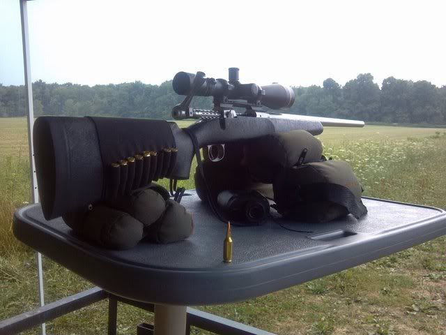

My 20br is also a Savage singleshot small shank action with a 26" Pacnor 9 twist with a RB SAV2 trigger bedded in a HS stock and topped off with a Leupold VXIII 8.5-25x50, I have many varmint rifles Remington's and custom actions and this one is my favorite although this summer I just built a 20-250 but have not had much chance to use it yet.
Here is a write up from GGVG. I also use the same die setup as you. I have not shot any bullets over 40 grain. I can push 32's to 4800 and 40's to 4200. You are down in Price or Helper right?

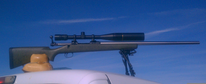

The rifle in the picture is my 20BR. The rifle is a Savage 12, SSS barrel, B&C Duramax Stock, Burris 20MOA Signature Zee Rings, Bushnell Elite 4200 6-24 scope. The little BR case does not feed well so I installed a single shot adapter. This is one of my favorite dog rifles.

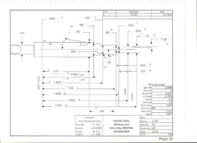

I would like to know who's reamer, and the specs, you are using for your 20BR builds. I put one together on a Rem 700 action, but never had the accuracy that my 20 Practical has. Was a lot of fun, shooting 32 VMAX at about 4200 fps, talk about a flat shooter.

I would also like reamer specs.

My reamer is from PTG I had it pretty much set up for the 55gr Berger the rifle is a single shot Savage action with a 26" 9 twist Pacnor barrel in a HS stock with a Rifle Basics SAV2 trigger and a Leupold VXIII 8.5-25x50 LRT it shoots pretty good for a Savage
What is the freebore for the 55's. I can't see the print clearly.
I have a barrel ordered and need to tell Shillen what freebore I want.

joghotrod i just ordered a barreled action in 20br from shilen as well. i want to shoot 40 vmax and 55 berger. i read that the short bearing surface of the 55 only needed .050 throat, but i dont think it would work for the 40. did shilen tell you what thier neck dia. was?

Yes they said their reamer has a .234 neck and a freebore of .010. So I will shoot 39's and 40's until the throat opens up and then shoot 55's. I might be able to shoot the 55's loaded a little short.? I do have some 50 Bergers that I usually shoot in my 1/9 twist Dtech AR that I can shoot also.
