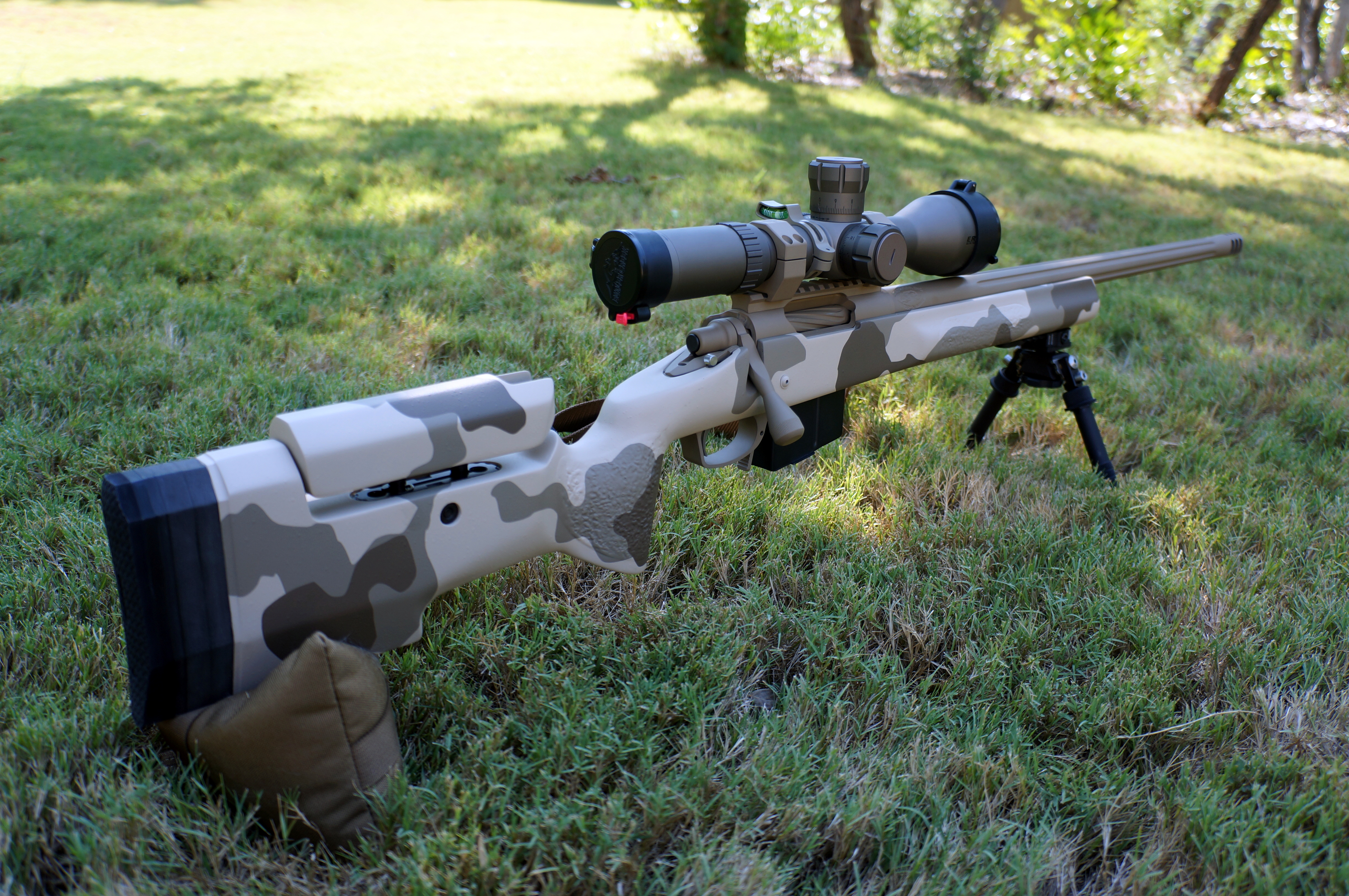

The rifle build is finally complete, and I was greeted to a gun case on my doorstep Saturday with a return address of LongRifles, Inc.
CHECK OUT THE PHOTO GALLERY HERE.
To say that the care in packaging taken by the folks at LRI was superb and left nothing to chance, would still be an understatement. Every piece, down to each piece of the scope rings, was in a ziplock plastic bag, inside a sealed paper bag, and wrapped in at least twice as much bubble wrap as would get the job down. The case itself was sealed with duct tape and had a zip tie through each of the 6 hasps for locks. Needless to say, everything arrived to perfect condition. The 2-day shipping was a bonus too!

Well I lied and took this one out to the range this morning.
Below are some targets @ 100 yds with loads of 42.5-44.0 grains of H4350 loaded into the land apx .010 with BR4 primers in new brass puching 130gr Berger Hunting VLDs. Circles on the target are HALF INCH.
Like I said in my opening post, I am new to LR shooting but not to shooting. What this says to me is that when I do my part I don't think this rifle cares what I feed it!??! That is unless someone with a little more experience can say otherwise.
I shot round robin, 3 shot groups with the 5 charges. Tryied to give the barrel some rest time, but it probably got slowly warmer all day. The 5 shot group at 43 was actually with culled brass during weight sorting. It was all on the light end of my lot, but was all within a 1 grain window.
No pressure signs on brass, not even at 44.5grains.
I was happy with the results, especially given the situation and my experience at this. Shooting was on a bench on a bipod and rear bag, and I didn't like the wood bench, a concrete top would have been nicer. Wind was mostly <5mph maybe a gust to 10 but I probably didn't shoot during any of those. About 80-85 degrees at 70% humidity. I only fired 2 foulers on a clean barrel. I shot through the chorno but haven't looked at the string details yet; ballpark it shot 2750 to 2880fps over the range of loads with my Pro-Chrono. I changed the bipod height between the 1st and 2nd groups and was more comfortable on the first, but that is relative as I am always uncomfortable on a bench being 6'6" on benches/chairs built for more average humans.
Comments?
There is some idiot on snipershide that is ragging on Chad in one of the threads over there. He has to be the most jealous sob Ive ever heard, but he hasn't even mentioned Chads girl friend, she is something to be jealous of.
Well the archery bow hunt was a success (see last pic below) so I am home and was able to take the LRI Creedmoor for another spin.
Shot a little better this time, was still doing "load development". The wind and my discomfort kicked up as time went on with the second target.
I was much happier with my own performance on this outing than the last. Those pics are in the previous post.
Since it appears this rifle will eat up and spit bugholes with whatever I put down it, I'm going to load the next 100 rounds (once fired now) with the 44.5g load. The other details are H4350, 130 gr Berger VLDs, BR4 primers, and apx to the lands at 2.087 at ogive with my comparator. This is a compressed load (as is 44g) and I didn't want to go any higher. I'm happy with 2872fps.
Any comments or ideas or something that should be learned from this that I haven't? I'm still 'new' to handloading and this precision game.
