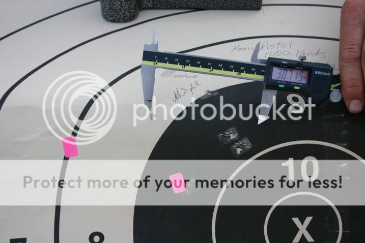

This is my best 5-shot group at 1,000 yards.

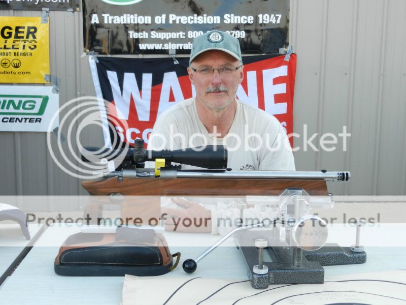

Eric Wallace (Nawakwa Accuracy) built this rig and it shoots and tracks like a dream.
Non-designated BAT action, 1-9 twist Bartlein barrel chambered in 7mm WSM, Nawakwa brake, Jewell trigger, Nawakwa bench stock (6” forend and 3” at the grip), Sightron S-III 8-32 with target dot, and I am using a prototype MAX Rest.
Winchester brass, Fed 210M's, H-1000, and 180 grain JLK's. Redding T-7 press and competition dies.
The 5-shot group was shot this past Saturday south of Sundance, WY at the 6th Annual MOA Cold Turkey Long Range Handgun Match at 1,000 yards and measured 3.8715 inches. http://www.moaguns.com/coldturkey.html
We have two classes in this match, and I shot this group during the Heavy Gun Class (Specialty Handgun weighing no more than 16 pounds and a barrel not exceeding 18”).
