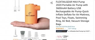

I use the "FlexTail'" pump off of Amazon, $19.00 and a piece of tubing . The pump is rechargeable, and I keep a battery pack recharge with me. I have thought about using a soft side cooler with ice packs in it, and run the pump inside it....thinking about hot gluing a lawnmower air filter into the side to take care of the dust/dirt problem...... Kinda like the old cool cans we ran on the race cars....rsbhunter

Here is one I have and it lasts through the day for me… also added a temperature strip to the barrel.
Bit of tubing from an aquarium store with one piece to step down the adaptor to a piece that fits into chamber. No need to make a cut off case or remove the bolt, the vinyl hose is flexible enough to just go around the corner… Yes, all the little pump motors are a bit noisy but the rifle is off the range between events and it is not an issue. Putting it into a small box or bag would quiet it down a bit if noise was a factor for you.

Here is mine. I liked it so much that I bought another one. Both from Amazon.
When I shoot with ambient temps above 75 degrees, my pump can handle about 7 cycles of cooling.
Since it takes only 7 rounds to get the barrel temp on my .223 above 115 deg F from cold, my pump runs out of charge just over 60 rounds.
I have been shooting about 100 to 125 rounds per session lately so I needed two.

Since you probably are wondering - Airflow is 250 L/min with 0.44PSL pressure. Provides about 25 minutes of running per charge.
My buddy has one that is slightly smaller, but has less air flow.
It is noisy - but is rated as <85dB
