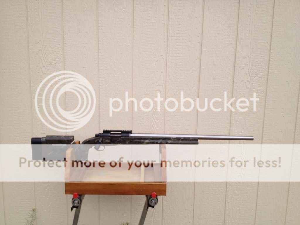

The rifle is a 6.5x47 Lapua, Remington 700 that has been trued and sleeved, with a 26” Rockcreek Tube, and it sits in a McMillan F Class stock.

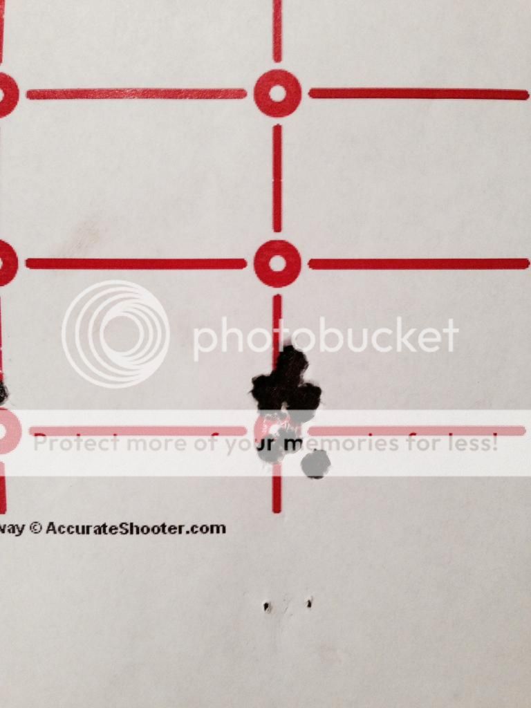

The first three rounds were my sighters, they were all loaded at 38.2 gn of H4350 they yielded velocities around 2656 fps.
Needless to say my jaw hit the ground. This may be business as usual for most of you, but being new to it that group had me giddy as a schoolboy…..
My shooting partner and friend was on the spotting scope and after the third shot there was a long pause and he finally said, I believe you just shot the best group of your life. I had my scope backed out to a low power, so I had no idea what was going on. I got up from the bench and started digging in my bag looking for something when he said, “no really, you need to see this”. When I got to the scope to have a look, it took me second to process what I was looking at. From that point on I smiled all the way home.

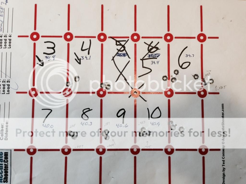

Getting back to it I followed those three rounds up with a 12 round ladder test noting the velocity and pressure signs of the cases and bolt lift. I worked my way up from 38.5 to 40.9 in .30 gn increments.
I guess the trend was predictable, as you increased the powder charge, the vertical spread increased. Ladder test still confuse me and I still struggle to understand the data. I think the ladder test needs to be run at 200-300 yds for conclusive evidence. What I see I guess is I have a node around 40.5 gn. After a days worth of shooting, I took the data home to reflect and chew on.

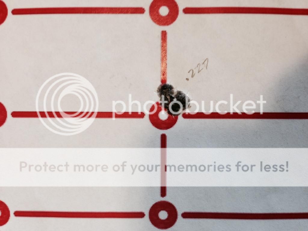

Being excited by my results, I got back in the reloading room last week and loaded 27 rounds, 1 fouling round, a 5 shot test group at 38.2 to verify that it wasn’t a fluke the time before, and 21 rounds for the OCW. The OCW starting load was 38.8 and the max load was 40.9, from my ladder test I ran previously I have a node somewhere around the mid 40’s. My goal for this session was to confirm and or discover a new node.
With freshly loaded ammo my shooting partner and I were able to hit the range this past Saturday morning. The weather was overcast, with rain in the distant air that lingered from early morning hours, this made the humidity quite high at 93% and our temperature around 73 degrees. We had a ESE wind of 7 mph. After everything was set up we set to work. I shot my fouling round, and then my 5 shot group test group.
It looks bigger than it appears. It’s 5 shot aggregate measurement is a .227”, the velocities were all within a few fps of 2655. Many have asked what else am I looking for, and not to be the stereotypical rookie chasing the white rabbit, but Im banking on there being a node higher up the scale with a little more horsepower. If this was a 100 yd bench gun, I would be set, but I feel like at 1000 yds the extra 130 fps will come in handy on a windy day.
With the barrel warm, I moved into my OCW test. Firing the consecutive volleys of sets A, B and C.
By my eyes it looks like there is a node from target 5 to 9. After 9 the POI starts trending upwards to a greater degree. To me it looks like the optimal charge is target 8 at 40.3.
