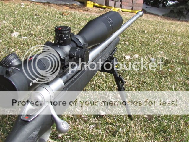

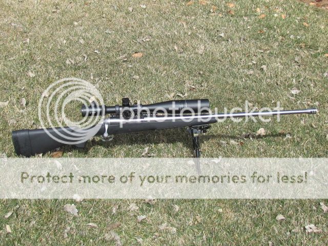

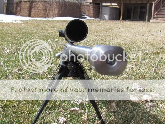

Hey guys i got my gun back from the smith on tuesday and i got the stock inletted and was able to mount the scope. Not much to look at because i dont have an aftermarket stock yet. Specs are:
Gunsmith: Nate from Straight Shot Gunsmithing
Action: Savage 116 Weather Warrior FCSS
Barrel: Bartlein 1:8 twist SS 5R #3 contour finished at 26"
Muzzle Brake: Center Shot Rifles Mini Magnum Muscle Brake
Trigger: Factory accutrigger that i reworked and polished to get rid of the small amount of creep.
Stock: Factory Weather Warrior Stock that i inletted for the #3 barrel.
Scope: Vortex Viper PST 6-24x50 SFP EBR 1-MOA reticle.
Caliber: 284 WIN with about .270 freebore and a .317 neck.
I planned to go shooting on Friday to brake it in but i snapped my cleaning rod and the news ones didnt come in time. I will update this thread with groups, and all the other fun stuff as it happens.
Take care, Riley
Sweet gun man!!! It looks like a shooter. What am I saying its a savage of course it's a shooter. That brake makes it look mean! In a really nice way lol
