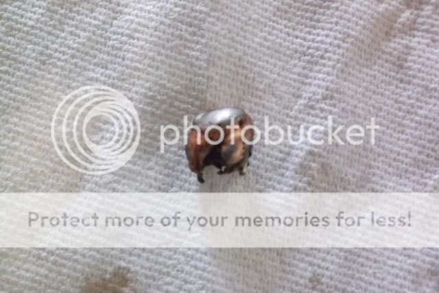

I punched one of the 129 Interlocks through the shoulders of a four-year-old white-tail buck at about 200 yards a couple days ago. The bullet blew through both front quarters and came to rest on the off side. It retained 72 grains and looked like an ad picture. Here is a pic of the bullet.
