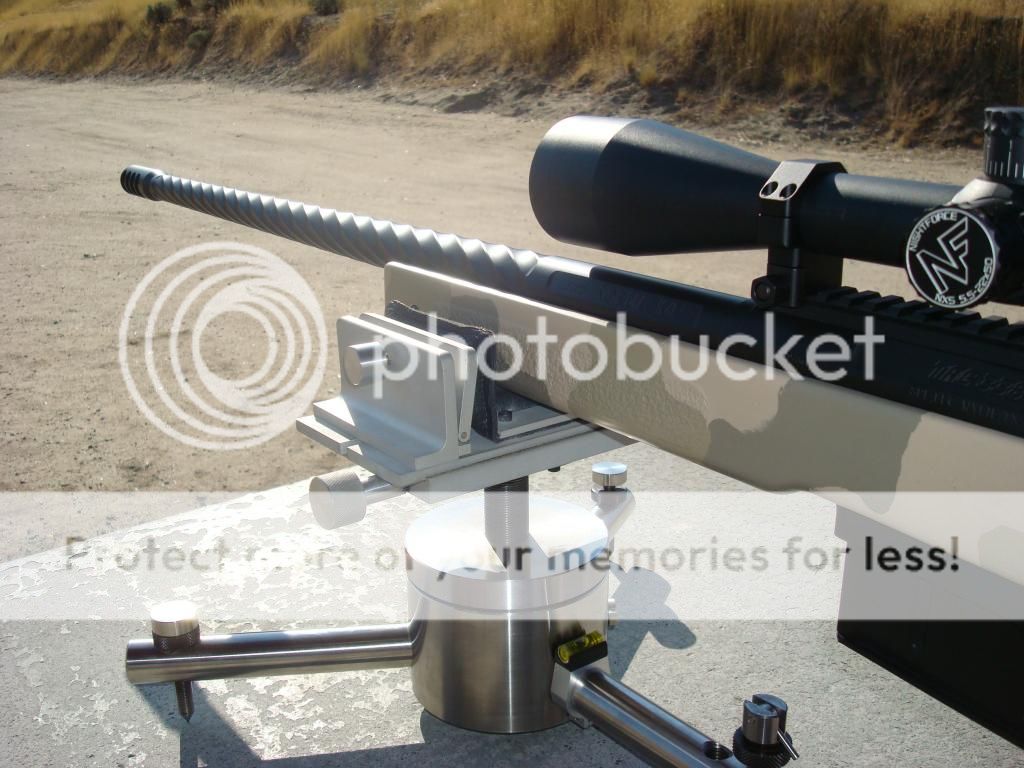

Must be the season for radical Vortex fluting
Seems to be a rash of requests for really aggressive fluting lately. Me likes.:cool: Remember, I have the capability to flute a barreled action without removing the barrel. So, bedding will not be effected nor lug alignment. Makes things very simple, and a very good option for factory barreled actions. Thanks for all the work to date guys and Happy New Year.
Regards,Paul

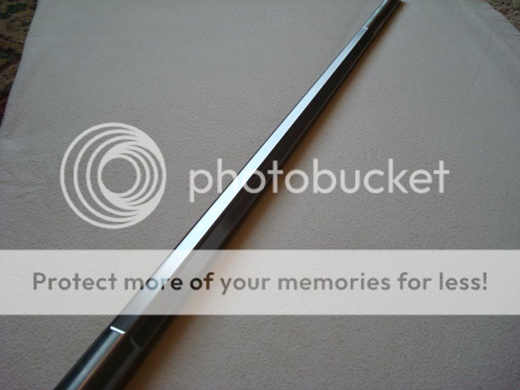

I can get within about 1 inch of the end of the barrel. Just have to have something to hold onto for the machining. I have done twists from 180 deg. to 1250 deg. One extreme to the other. Here is a
pic of the most aggressive to date. .388 Norma Improved with 1250 deg. of twist. Just let me know what strikes your fancy. Very easy to program twist changes.
