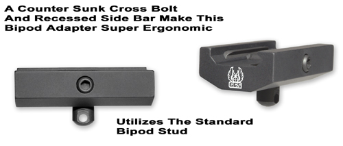

Do you have a chassis in mind? I'm wondering if you have M- lock mount available or if you will be attaching to a picatinny rail or Arca rail? One thing I've heard done is drill and tap for a swivel stud.
Looks nice, but looks like it clamps to a rail? This MPA doesn't have a rail or anything for that to clamp to? Just has a bunch of circle holes on the bottom of the forend.
You could try screwing a sling stud in one of the holes with threads, guessing it is a 10-32 thread, MPA could verify.
Another option, get a short pic rail and mount to the threaded holes at the end of the chassis forearm or buy a spigot from MPA and use the GG&G adapter.
