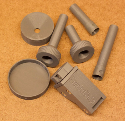

If your Redding is a model that will take it, your die changes will be much improved with a lock n load conversion. A friend 3D prints a gizmo that lets you drop powder directly into your scale's pan, while it is on the scale, which should speed things up a bit. The one in the video is a Lyman 55, but if you message him, he can make you one for your Harrell's.
