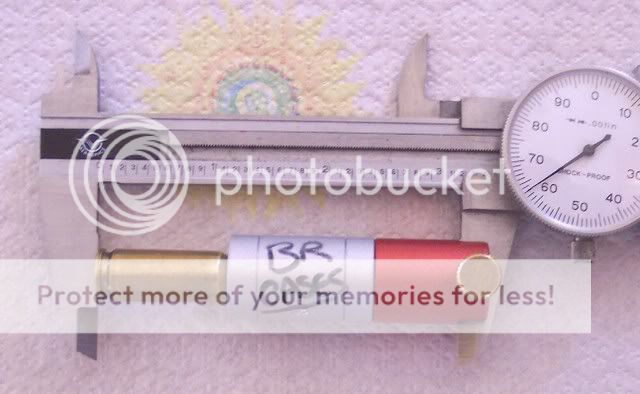

Here's a couple of pics of the Hornady tool. If you look closely, you can see that the shoulder is back .002 on a sized case. This tool (or one like it) should be the first tool any serious handloader buys, IMO.
I measured the same way you did except I used the bushing bump die instead of the tool clamped to your caliper. The case shoulder seats against my die in the same manner it seats against your tool, allowing a comparison measurement. An absolute measurement is un-necessary since delta L (lenth) is what we are interested in. Like you say, the delta L in your photos is .002. The delta L in my measurements was .004 - .005 over a virgin case length. When I bumped the shoulder back with the die, it measured almost exactly what the virgin case measured. Problem solved. The only question I am left hanging with is; why didn't the full length sizer get the shoulder back where it should have been?
