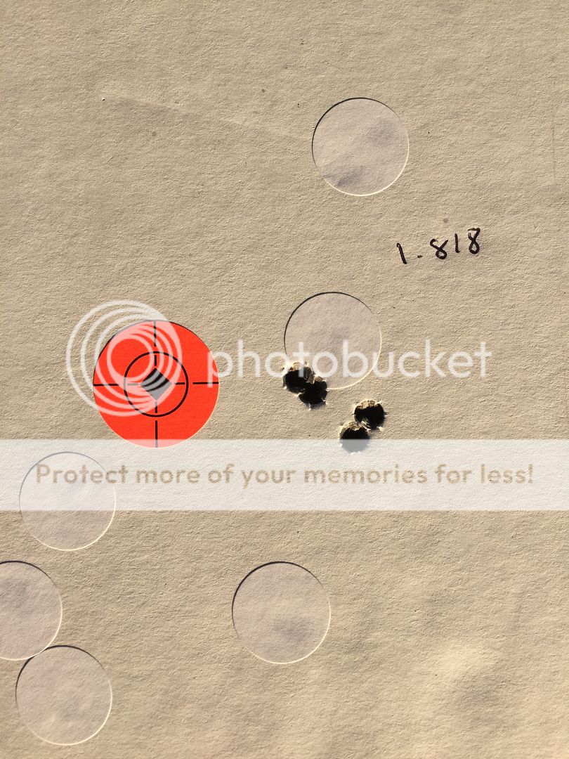

Next is 36.0 grains of H4350 this to is at 500 yards
This group measures 1.431 CTC with a vertical of 1.279 and horizontal of 1.064
Needless to say the 35.8 grains is the load in this rifle.

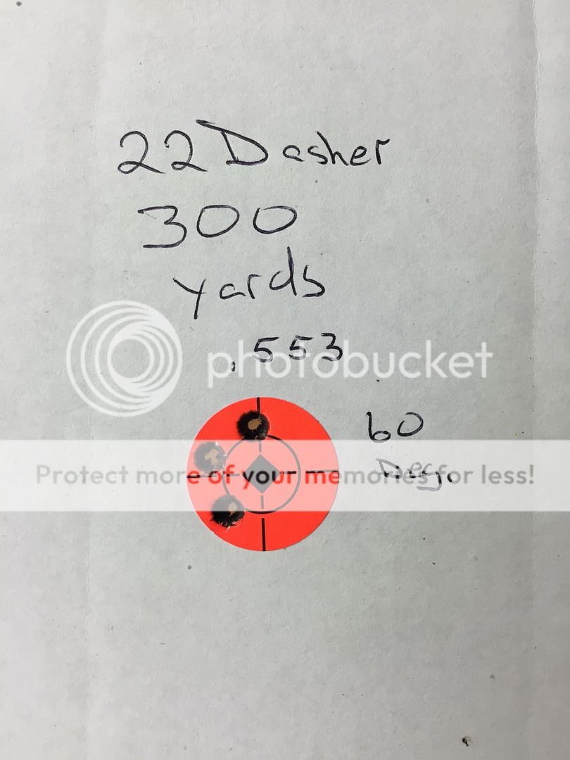

Now onto my new barrel the one I'm known for. It's a 22 Dasher, Saturday I screwed on my old worn out record setting barrel and fire formed 50 cases and then neck turned them. That evening I began playing with loads and it looked like at 100 yards I was going to be around the 35.8 grain mark as well with a 80 grain Sierra MK moly coated. So once I established a baseline load I loaded up rounds starting at .020 off the lands and moved towards the lands in .005 increments until I was .010 into them. This morning (Sunday) I was up at 5am and at the range and setup at 5:30 and began testing. I decided this go around I wanted to do my initial testing at 300 yards instead of the usual 500. I'm only posting the best load of this test as from there going towards the lands the groups gradually got worse. So here's my test group at 300 using 35.8 grains of H4350 this is also .020 off the lands.
This morning it started out a bit cool the temps were 60 deg at testing.

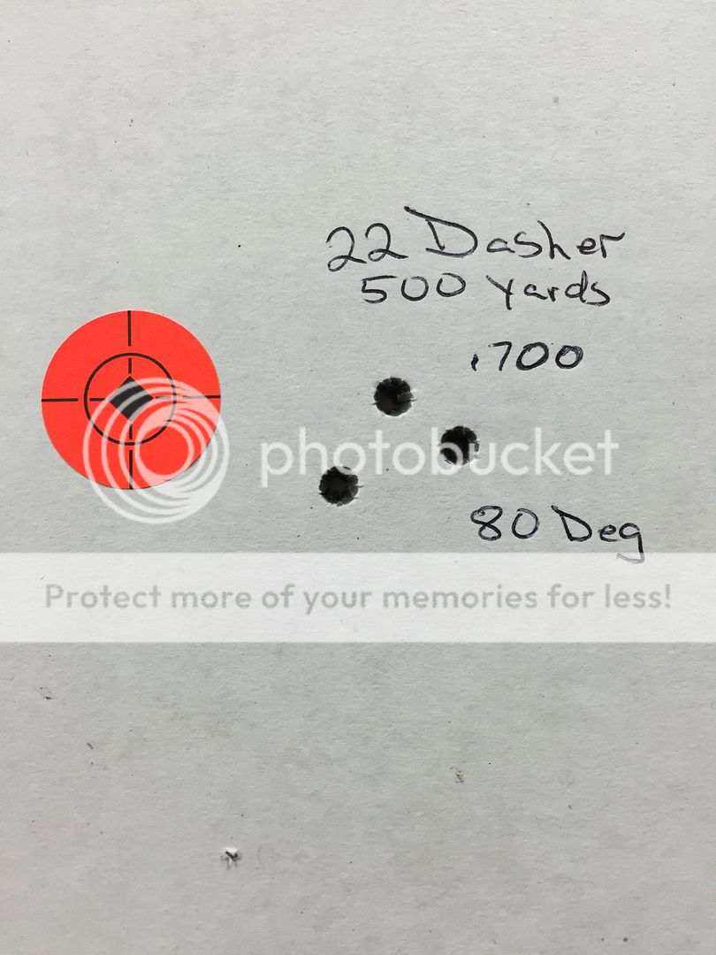

This evening since I was already sighted for 500 I decided to to run my test for powder charge at 500 as well. The loads started at 35.6, 35.8, 36.0 and 36.2 grains of H4350.
Here are the results at 500 yards of the best group shot. This is 35.8 grains the exact same load tested at 300 with same seating depth as well.
OnTarget actually has the group a .701 with vertical of .494 and horizontal of .668
