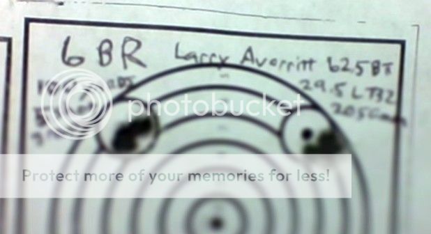

more 6BR 13.5 twist tests
got some 62.5 gr BT`s that Larry Averritt made and started with 28 grs LT32,,went as high as 31.5 grs but with no pressure signs and not much change in groups,so I loaded 10 at 29.5 and the rifle seemed to like that load pretty well also,,
sure is a fun caliber to load for and shoot,,
shot 2 5 shot groups today in between showers and thunder and lightening,,wind wasnt real bad,at least was switching directions, just gusts and letups,,

I shot Barts 68s with 29.5 LT32 going 3350 at our first UBR match this year,,it shot great considering the conditions,,with 33.5 H335 I get great 5 shot groups at 3500 fps but havent shot it in a match to see if it will hold together over an 7 hour time span and the temp and humidity changes over an all day match,,
I may try it next w/e just to find out,,
at 34.2 H335 the 62.5s shoot really good at 3610 fps from the 23" 13.5 twist bbl but again I am kind skidish of shooting a load that fast in match conditions,,
I may try that load next w/e also but just havent decided yet,,
I know what the LT32 load at 3350 is gonna do but would sure like the extra help of the 3600 fps load in the wind but I dont want to be fighting a bunch of vertical ever few minutes as the temps and humidity start to go haywire,,
the 68 Barts shoot really well with 32.2 VVN 135 right at 3400 fps,,
heck it shoots everything really well ,,I just need it to stay on track all day and I know the LT32 load will do that even if it is the slowest,,
