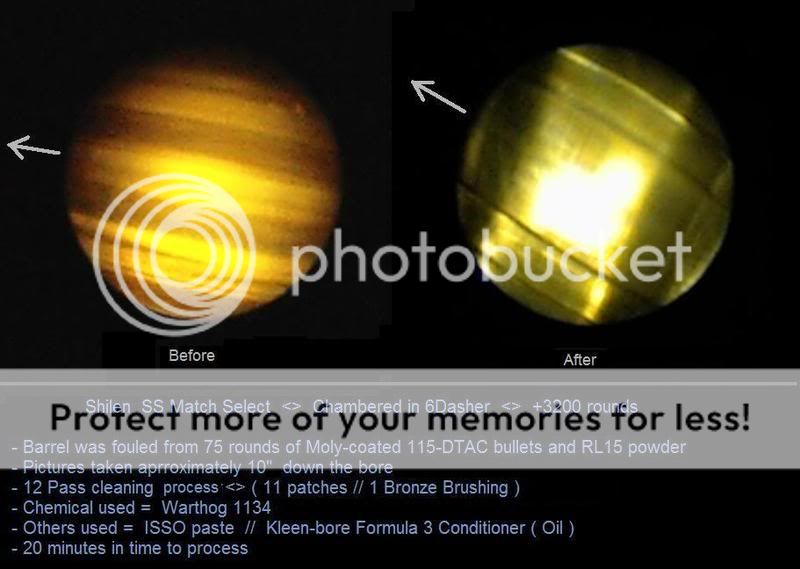

Dawn dish soap on a brush removes the moly from the barrel. At least enough.
Moly does not build up. There lots of guys who go back and forth between naked and coated.
