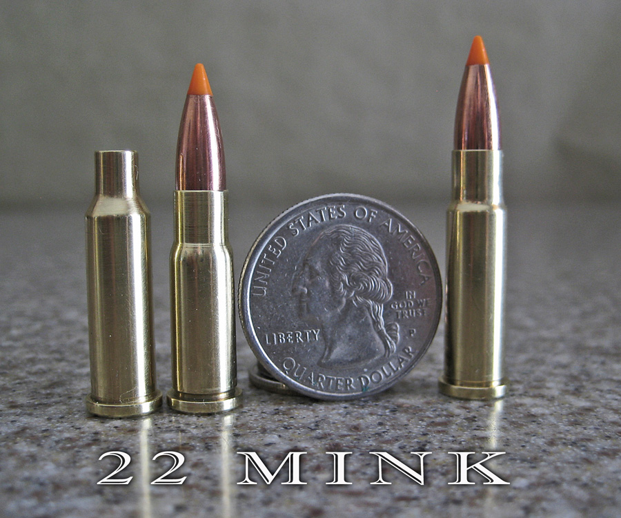

Can I have some suggestions on a tabletop or a minilathe for such work. Case trimming, inside/outside neck deburring, flash hole cleaning, primer pocket cleaning, etc.
Here's a couple images of my cases, just to give you some perspective on the size I'm working with.

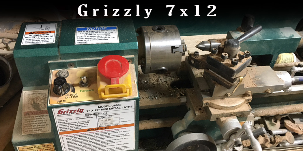

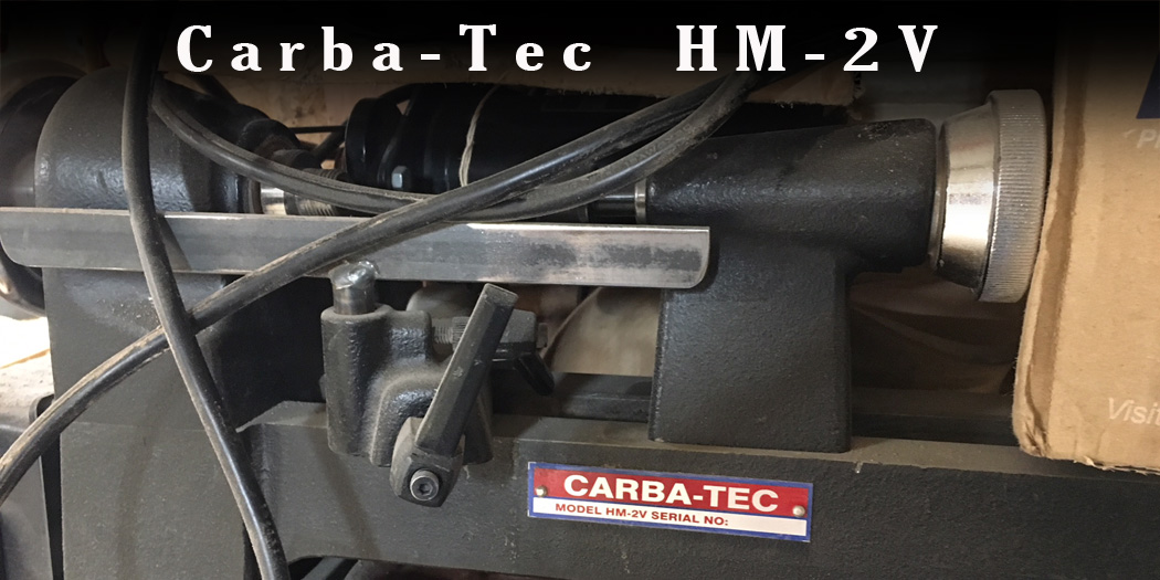

This is what I've come across so far at a local surplus store. Would any of these be potential candidates for - flash hole uniforming, primer pocket cleaning, in/outside neck deburring? Or, would these be more trouble than they are worth in trying to find attachment and mounting options to work with these lathes?
Of the the ones you have posted.. i would get this one, the others are primarily wood lathes
Grizzly also makes a tiny 4x8 lathe that might do the trick. I have that Grizzly 7x12. It’s a tough but capable machine and it’s one of dozens on the market just like it. You can turn 1” 416 stainless on it. Plenty of power for case operations. Heck, you could make cases with it if you know what you’re doing (something I dont recommend unless you are *sure* you know precisely what you’re doing).
