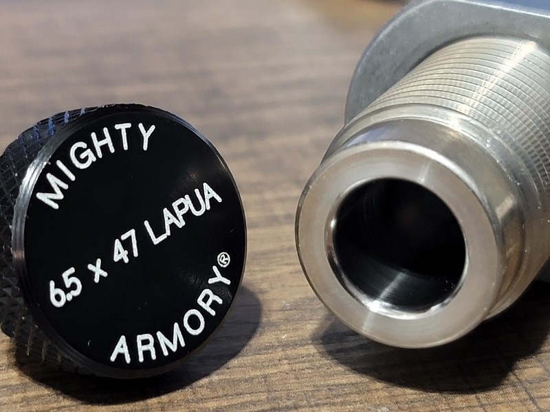

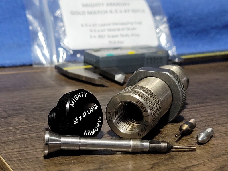

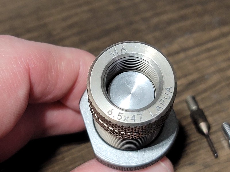

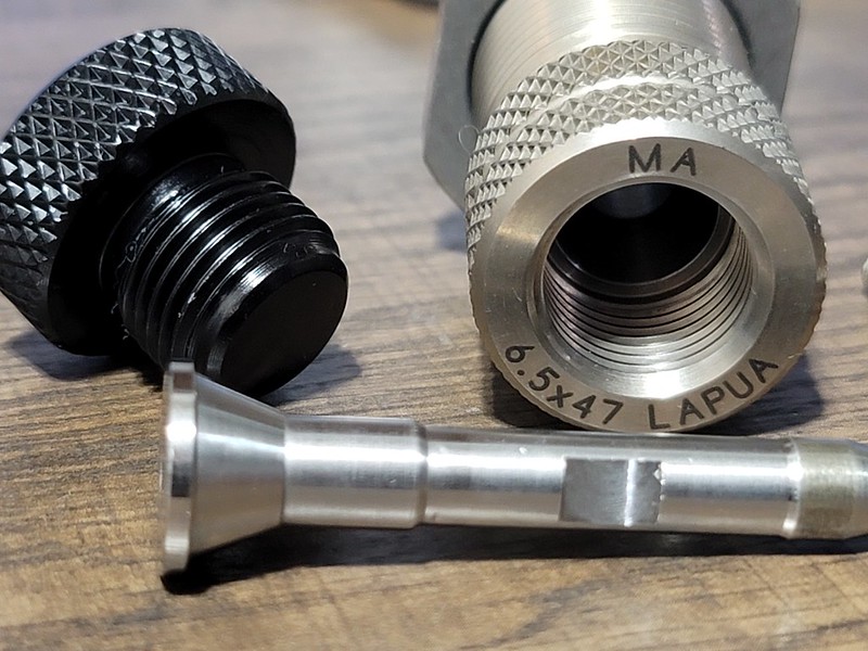

My Mighty Armory 6.5x47 Lapua die arrived. Impressive shipping speed and the die looks and feels very high quality! Looking forward to trying it out in the next few weeks.
