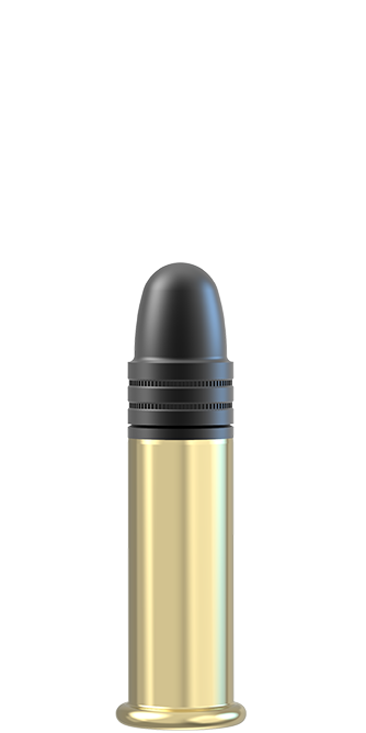

My local club is doing a 22lr match that will be shooting out to maybe 300yds. I wanted to take my gun over and find the drops before the match. Could someone please give me the BC of the 40g round nose so I can get an aprox. to feed into my calculator..............Thank You

22. I've tried the Kestral, Shooter, and Applied ballistics. Download the A.B. app and plug in a G7 of .062 give or take a point. I know it doesn't make sense to use a G7 . 1107 fps is what works for me.. Velocity will be the question as will temperatures. Different lots run at different speeds. Applied Ballistics is solid for me out to a bit over 400 yards.

These darn 22s are fickle past about 250 yards. One day to the next is a new adventure even if you think you have all your settings locked in. I use strelok pro and RA4 drag function. I have never once seen anything that will capture the trajectory with one constant BC. I shoot my drops and pay very close attention to wind direction and speed, elevation, temperature. Once that data is collected I literally use a multi point BC based on velocity drops until I get things fudged in to match my actual drops from shooting.
Keep in mind rimfires are not immune to temps either. You will need between .5-1fps per degree.
