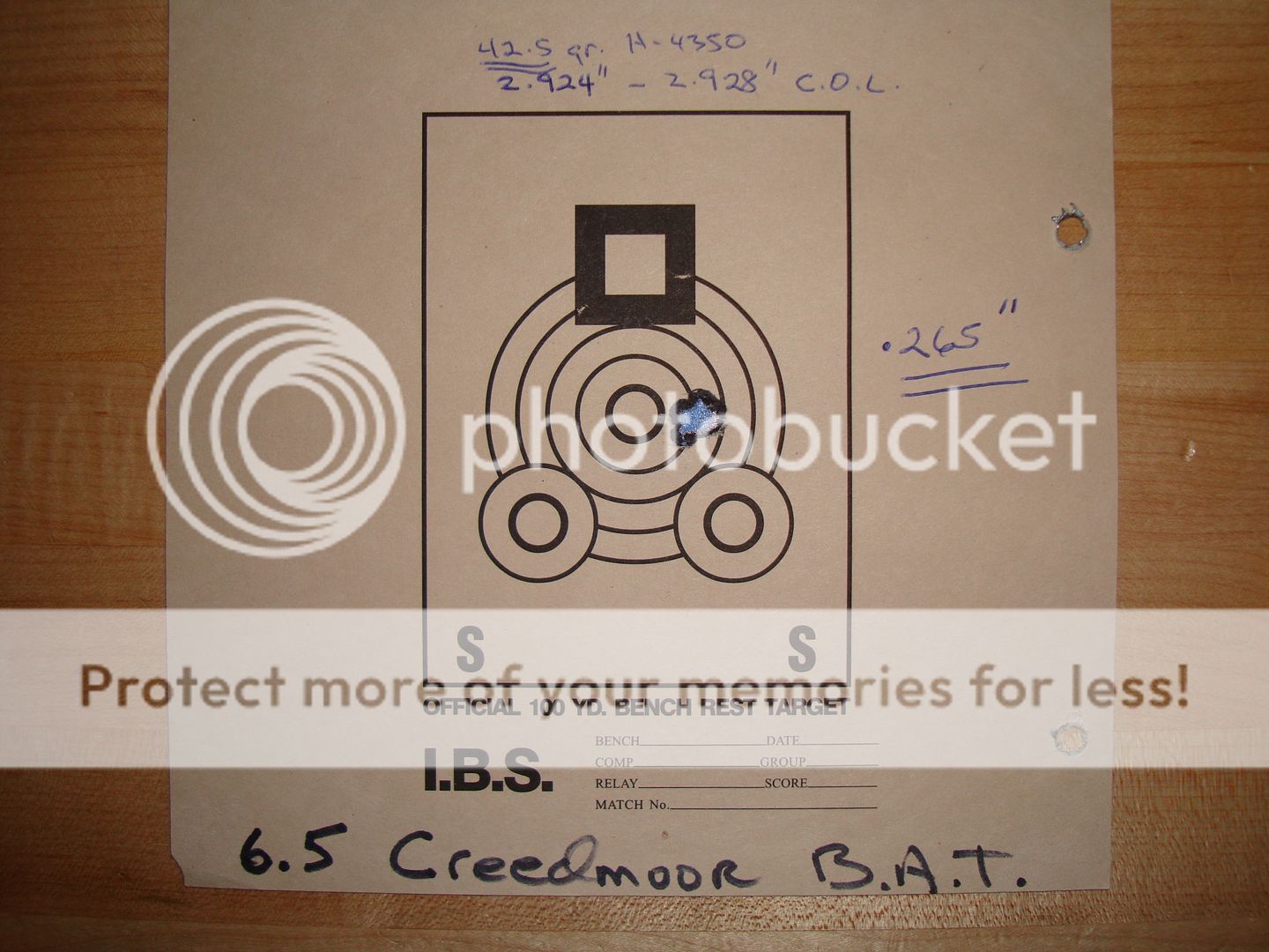

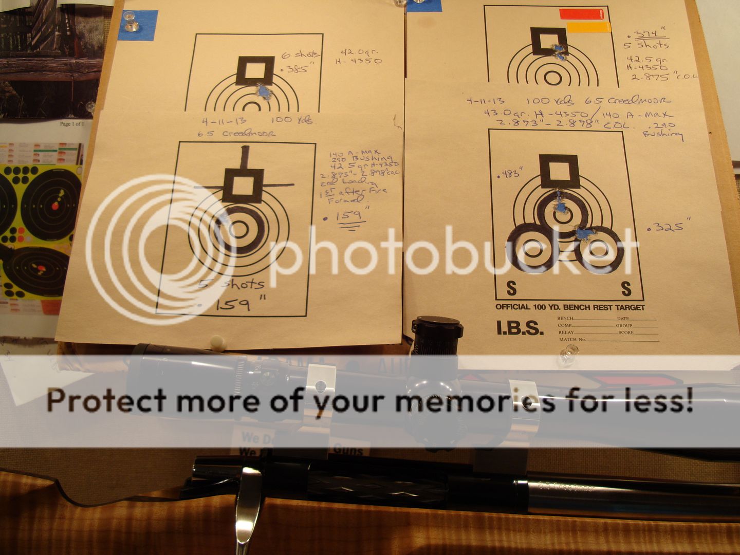

Not sure it's the ideal Elk cartridge but it obviously gets the job done. I've got mine to where it shoots 1/4" groups with most of the major target bullets and a few that are definitely NOT of the target persuasion.
