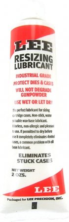

The Q-tip can apply more lube to one side of the case neck, then the other.
As a boatail bullet is seated, the lube gets compressed between bullet & the inside of the case neck wall. A slight bulge is formed.
Concentricity and bullet run-out are effected.
Depends on the lube type. May not be an issure, unless using something likes Lee Case Sizing lube? 71qP6n1RyRL._AC_SY879_.jpg
