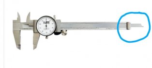

Measuring Primer Depth with Calipers
How do you know you're seating to the bottom of the pocket when seating by feel? OK, that you're getting very good results with the way you're setting them, but . . . you really don't know you're seating to the bottom, huh?

I think ideally, the pic shows where it's thought where seating at the "bottom" is. When the primer cup height is .118" (like CCI-200's) and the large primer pocket is .127" deep, the primer is going to be .009" below flush when seated that way. Or even .010" below flush if using Fed 200's. Take SRP's pockets that are .120" deep using primers with cups that are .109" tall, that would be .011" below flush. Do people really seat their primers that deep when seating by feel? And, isn't that a lot of crush going from a primer with an over all height of .121" to .109" when at the bottom of pocket (e.g. your illustration) an awful lot of crush?
It's been my understanding that .003 to .004" of crush is recommended (crush being the amount the anvil is pushed into the primer cup). And to do that, is the bottom of the pocket that's pushing the anvil into the primer cup. Or have I misunderstood something all this time?
When I seat my primers, it's been my objective to seat my primers with .003 to .004" of crush. My 21st Century seater, being adjustable, does are decent job of doing that for me as I use its ability for a hard stop. My ACP does a better job and more consistent (it's adjustable too). ;)
